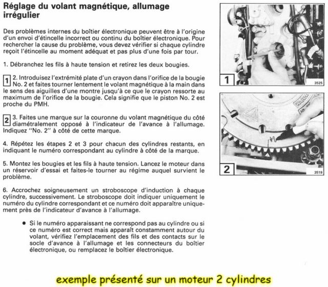

bonjourci joint control
ci joint control allumage
bon courage
bon courage
